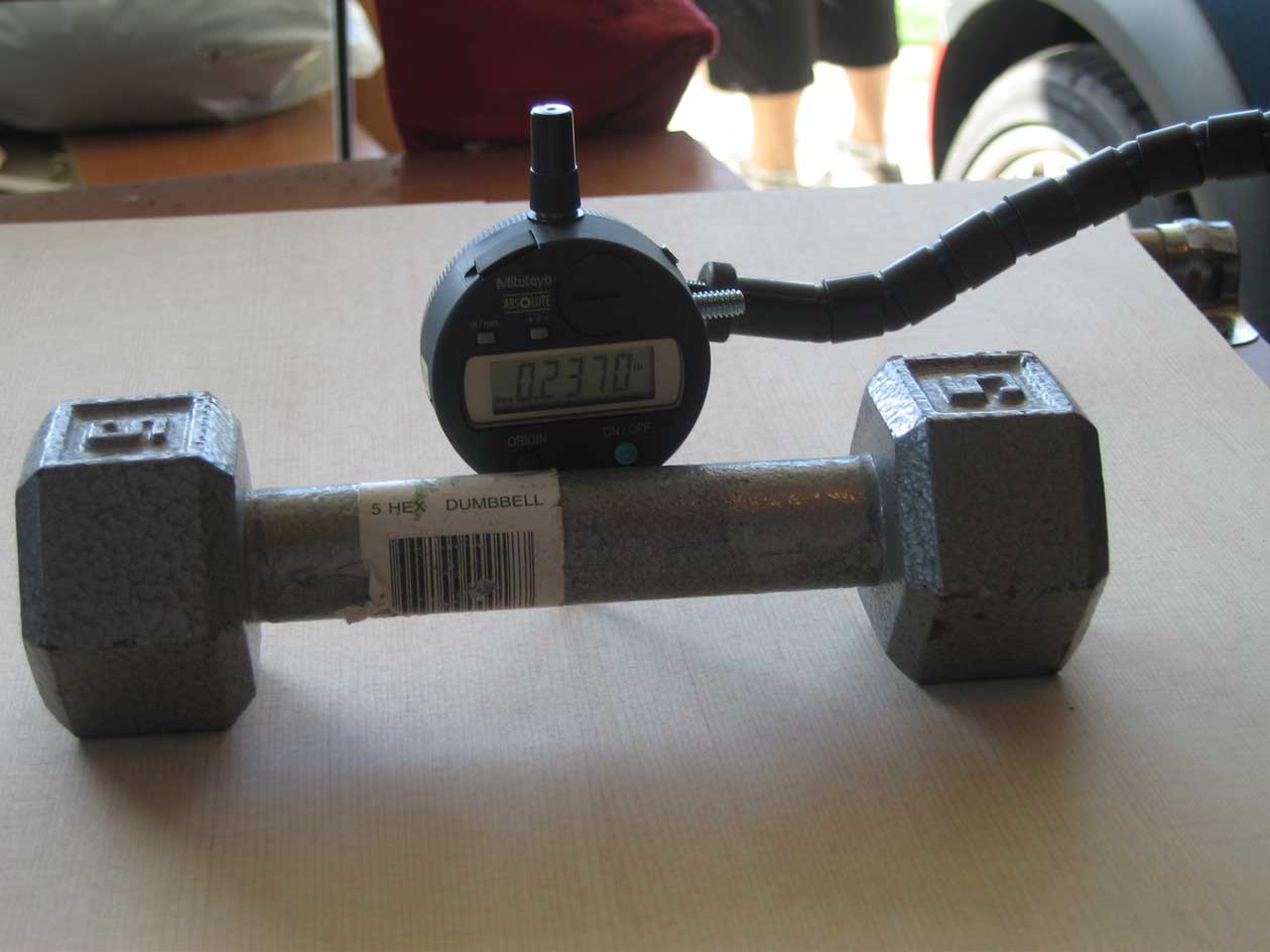

More points. The advantage to deflection testing is you can get some hard data with regard to stiffness. Each piece of wood is unique and should be treated accordingly.
Why thickness each top to the same thickness???? My analytical brain thinks that is rediculous. I have felt many pieces of wood of the same type that were DRASTICALLY different in stiffness. If you thicknessed all of them the same and made guitars with them, they would all be different.   Also each body size changes everything. A smaller body guitar is different from a dreadnaught.
My set up is just a table with 2 bars and a dial indicator.
Simple as that!!!! I just put a dumbbell on it.

Matt I dont thickeness to a standard thickness, but to a stiffness

PostPosted: Thu Apr 26, 2007 10:14 am
[QUOTE=azimmer1]
Matt I dont thickeness to a standard thickness, but to a stiffness[/QUOTE]
Andy,
Is that only the cross-grain stiffness that you measure (as in your pic), or does longitudinal stiffness come into it too?
